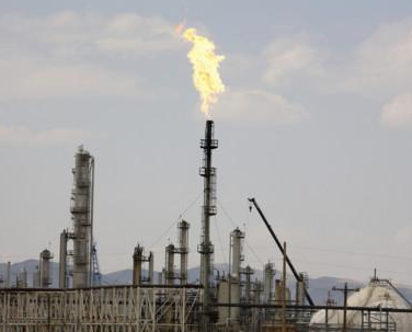

Something like the oil refineries have where they burn off excess gas. ![]()
Ooooo! fire!
I’ll eat a 5way and recreate that picture at the meeting tonight. Will you hold the lighter Brad?
