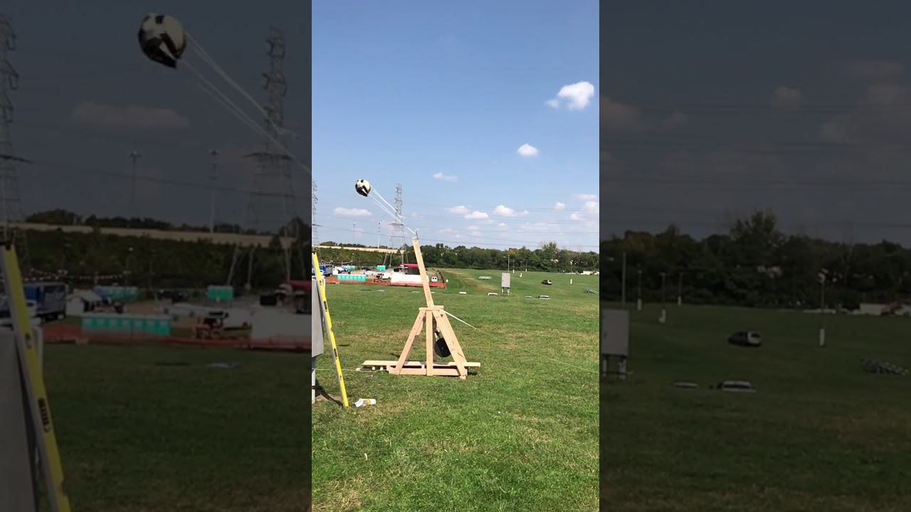

Here are 2 of the videos we took while testing the Trebuchet. I have a lot of additional videos that I can provide, if anyone wants to try some adjustments on it for firing. a few spectacular failure videos as well.
It currently throws right around 55 feet with a good looking arc. I haven’t measured the exact angle yet, but I’m guessing around 35 degrees. 45 is the optimal release angle, so some additional changes to the sling length and pin angle could be done if someone wanted to try it.

It was working very well. We were getting consistently 75-80 feet with the basketball. We even managed to chuck a small pumpkin that weighed about the same as a basketball. It smashed on the second try. (sorry no videos).
