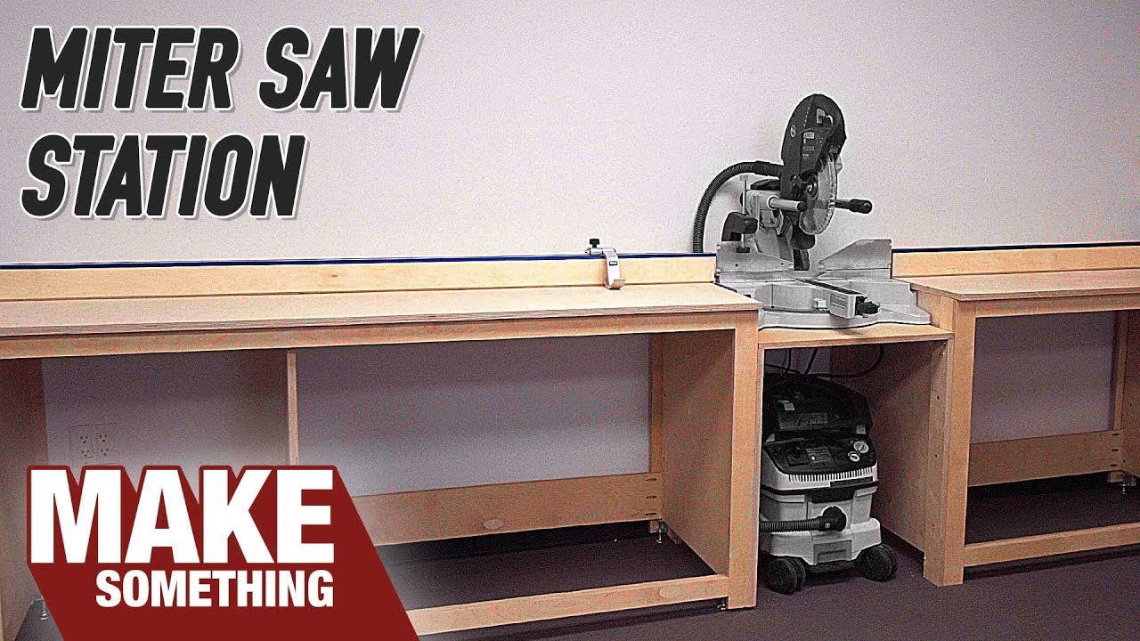

What does everyone think about building a miter station of similar construction to this:

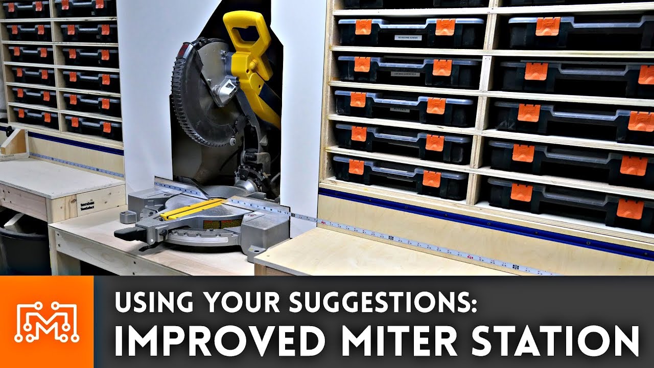

with dust collection/shroud similar to this:
I think this type miter station would really maximize the use of the new saw, as you can just walk up and make the cuts you need without having to worry about setup, adjustment, and then cleanup afterward. The base cabinet construction is also a good strong construction that will be durable and would allow us to add drawers or shelves underneath for storage of tools, blades, consumables, etc.
