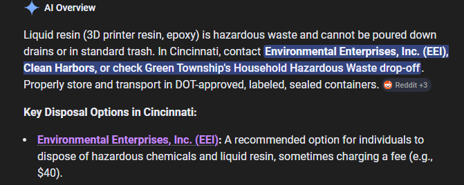

On waste management: there should be very little waste overall. I don’t anticipate us filling a full container of resin under normal use. I agree that switching from a plastic container to a metal waste container makes sense. I spoke with Environmental Enterprises Inc. – Plant & Lab Pack, located at 4650 Spring Grove Ave, Cincinnati, OH 45232. and they confirmed we can drop waste off on Tuesdays or Wednesdays between 7:00–11:00 AM for $40 per disposal.

The disposal place takes up to 100lb for $40 of waste.

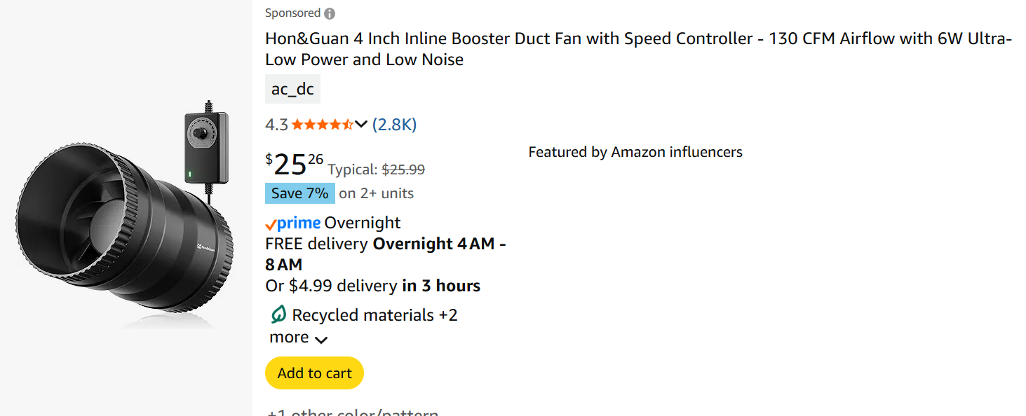

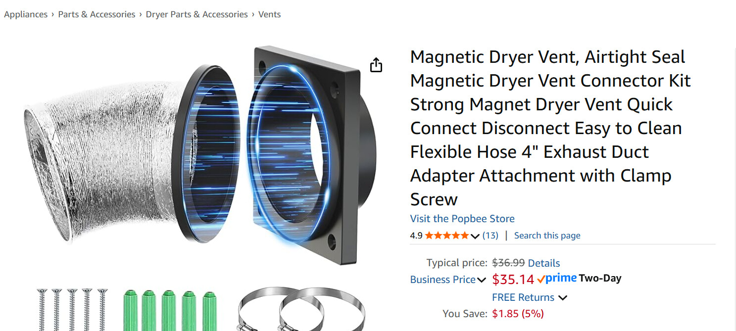

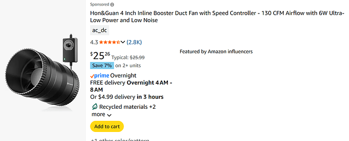

And for a box for the isopropyl bath, I have listed below a fan, duct, and outlet(window)
Amazon.com vent $36
Amazon.com vent w duct $30
Amazon.com fan $26
Total added cost $92
Just a simple bath fan like this in the outside wall of the 3D printing room would be sufficient. Really, should have one for FDM printers too, most places with proper EH&S programs require ventilation in any space with 3D printers, as some of the plastics offgas stuff that’s not great even for FDM.
