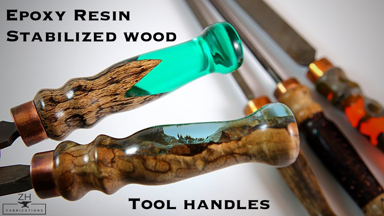

While the Vacuum Chamber will be an upcoming project, I Brought in a pressure pot today. I also have noticed a few of Hive13’s tools could use handles, anyone want to try and replicate some of these with me?
Kevin I been wanting to check out lathed Resin for a while. I would love to see whats up. I also can bring in my Vaccuum Chamber.
