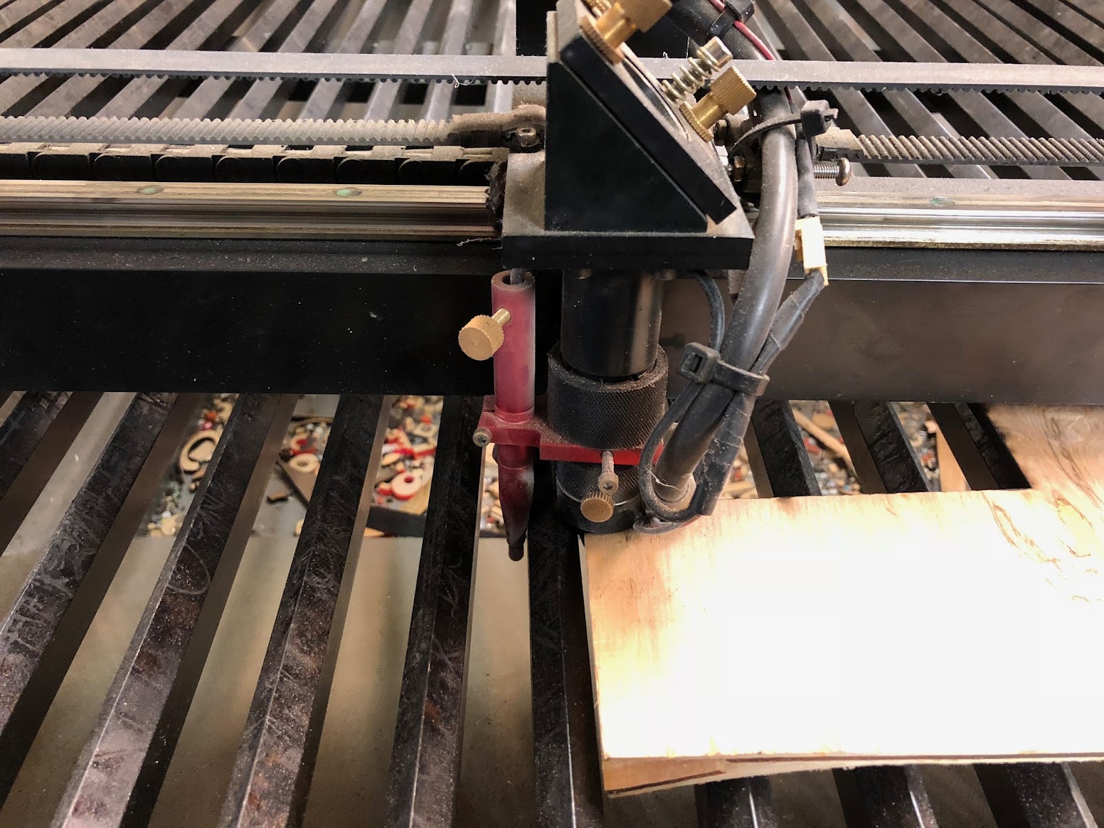

I checked out the laser. Looked like the Z probe missed the target and then table just kept going up till it crashed.
I had to manually turn the Z threaded rods to free up the table. I then got to do a table Z alignment.
Now all four corners are within about .5mm Z. I also aligned the aiming laser so it lined up with the actual laser. While I was doing all this I also lubed all the threaded rods and linear bearings. I also emptied the bottom drawer that collects all the little prizes that fall down during operation. If you unlock the lower front doors (using the other key on the laser key ring) you can just pull out the drawer and empty it in the trashcan.
I did a materials test with some scrap wood and everything seems to be working.
