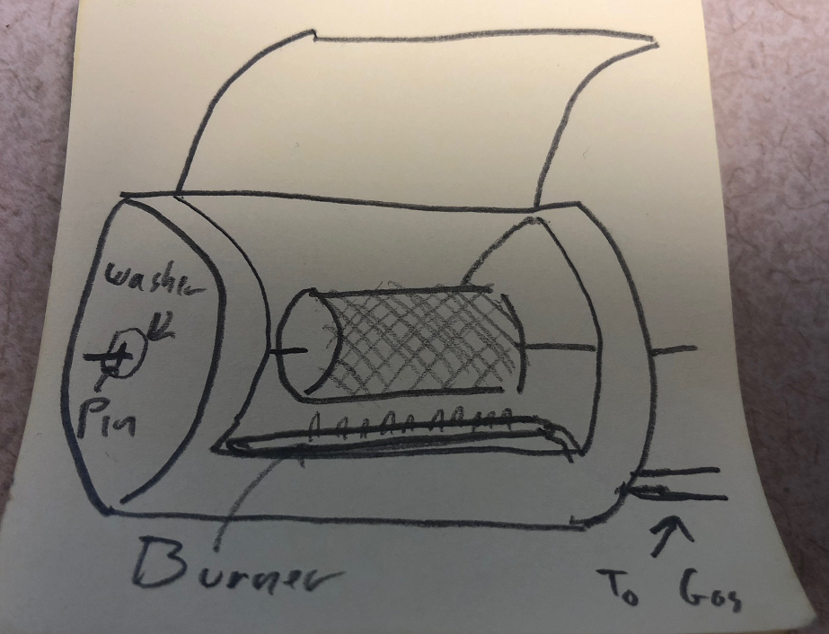

Its for a coffee roaster it has a motor to move the coffee a gas line on the bottom to heat the drum, ( or used a weed burner whatever is easier). what i need is to also cut the drum to a smaller size so it travels easier put in a door or some way to removed the basket that holds the coffee. and make holes to put in bearings for a smoother spin. i have attached a poorly drawn idea.
we are also open to new ideas, this is just the one i came up with.

The sketch concerned me.
No temp control, not easy to load or unload. Can’t tell when it’s done.
Seemed like a way to ruin a lot of coffee. Saw this on youtube.
You’ve covered the “toxic contents” part of his concerns perfectly. The plastic liner… not so much. I would burn the living shit out of it before roasting coffee. Speaking from experience, here.

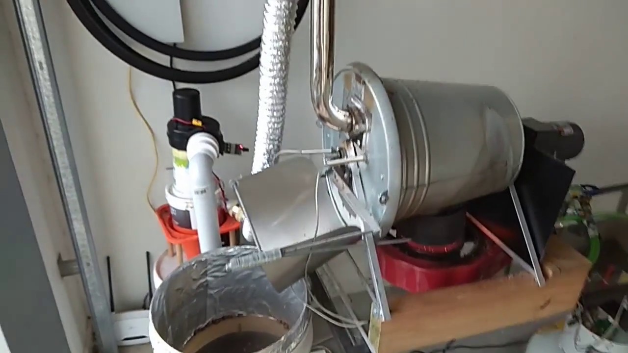

This would likely be an easier way to do that. You’d be able to have a longer roaster tumbler, which would give you an increased surface area for roasting.
In either case, you don’t need to weld anything. punch your holes all the way across, run a rod all the way across and use a large washer and a cotter pin on each end to prevent it from sliding in an out.
