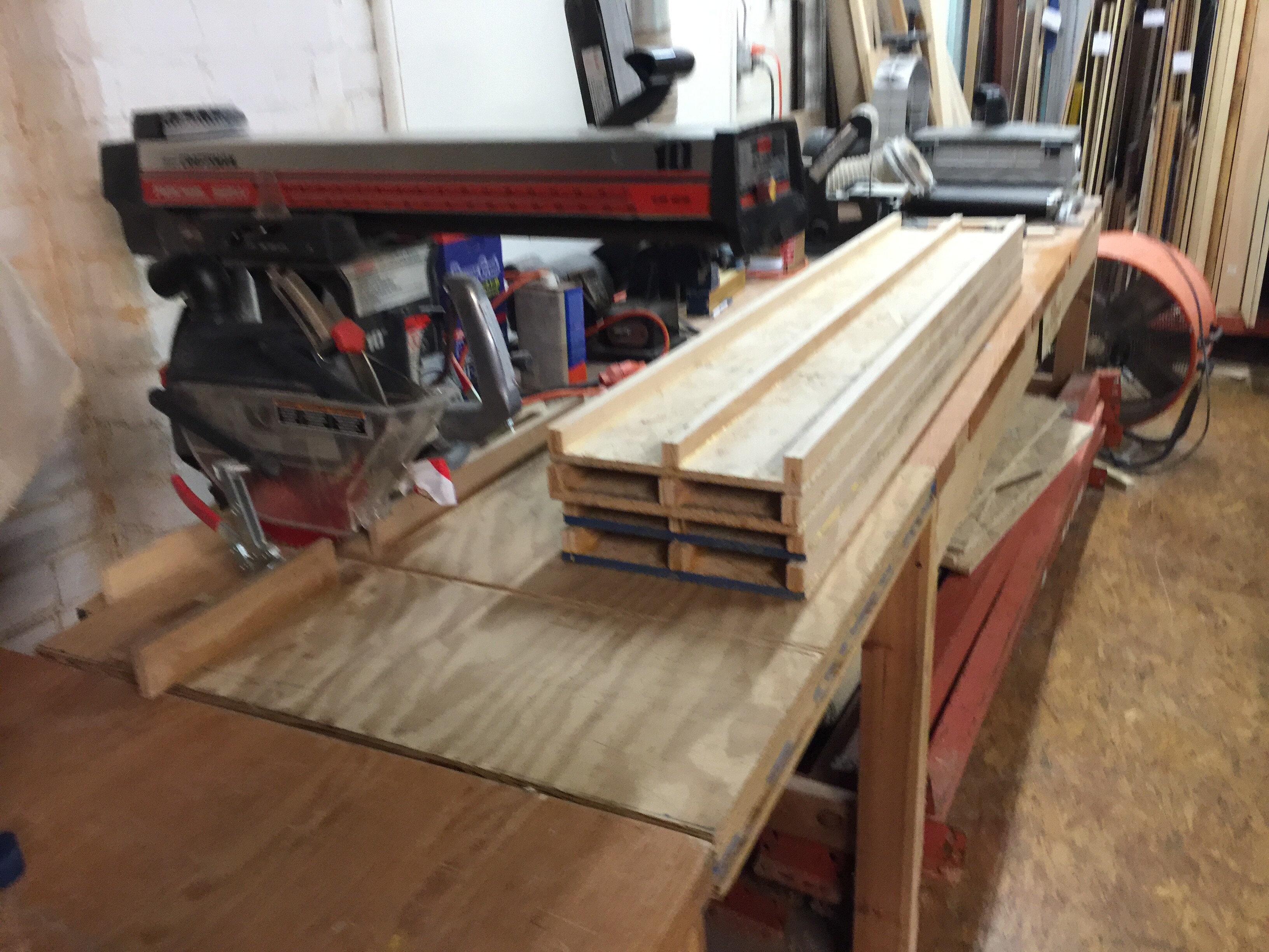

With thanks to Tim for a great deal of assistance, the shelves have been assembled and are drying on the radial arm saw workbench. The glue should be set by this time tomorrow.
Following that, they just need to be trimmed to length and placed on the mounting rails. I can hit this Tuesday after the meeting if no one beats me to it.

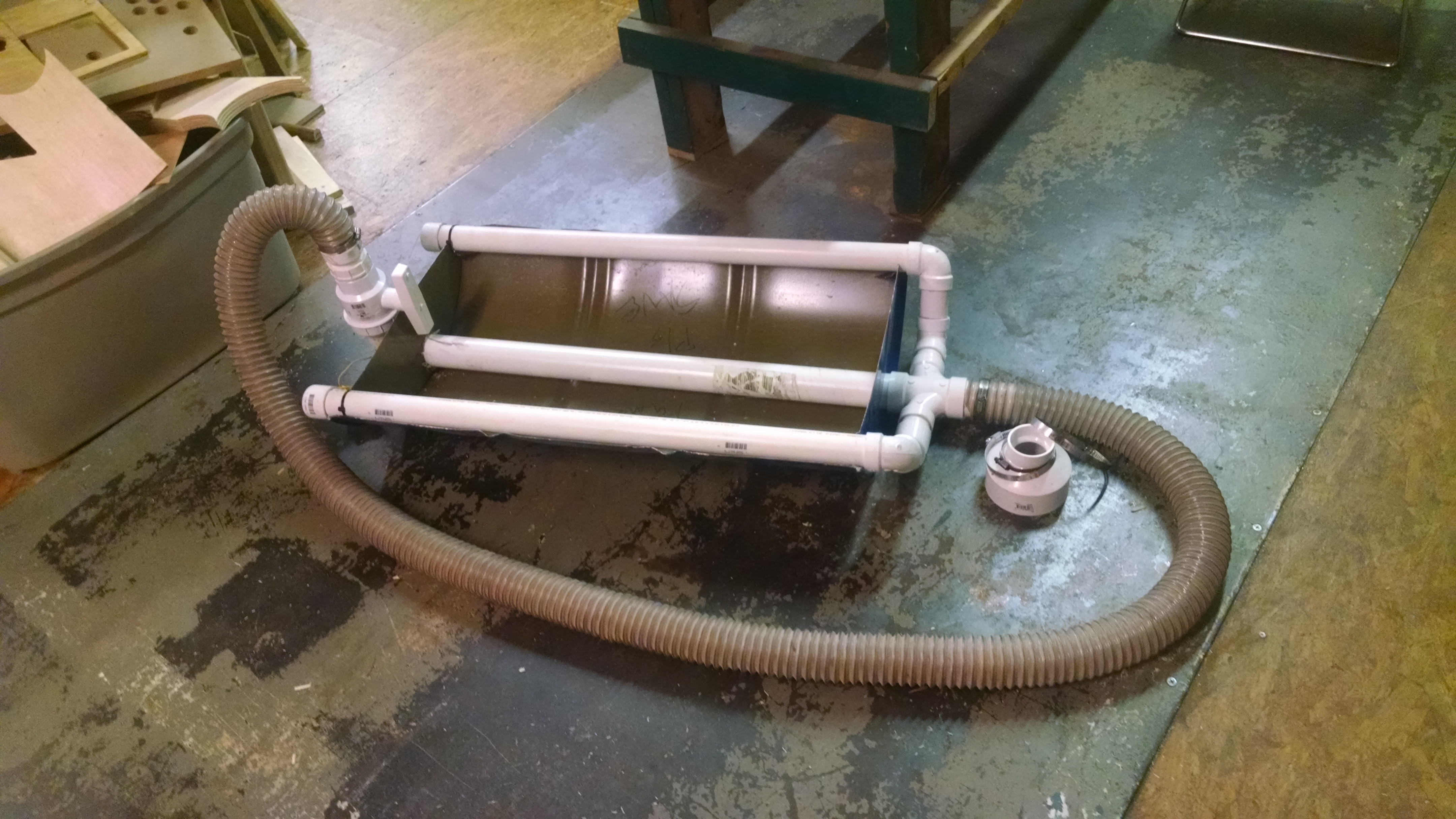

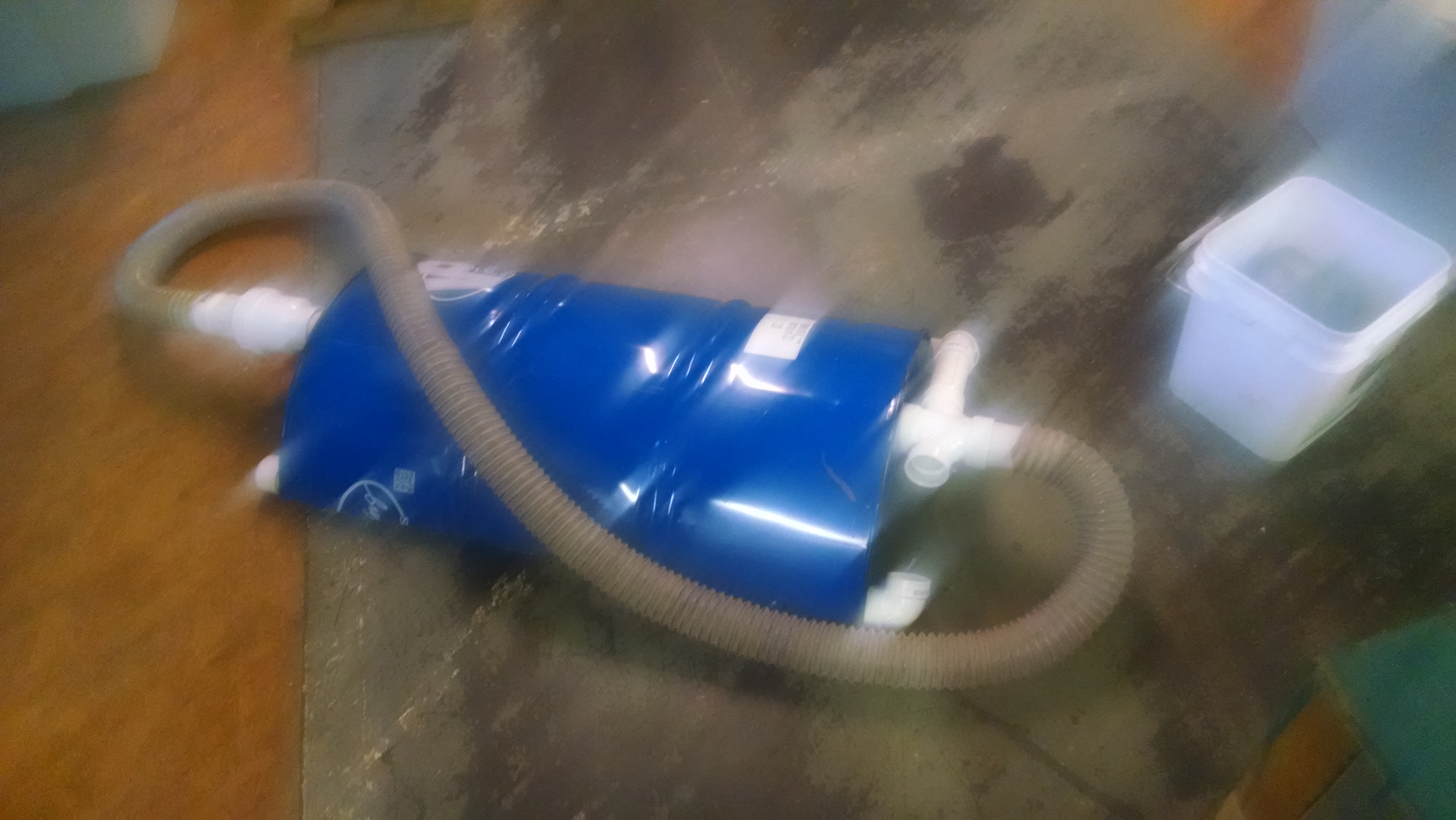

I got a decent amount amount done on the extractor hood. NOT EVERYTHING IS GLUED TOGETHER!!! PLEASE BE CAUTIOUS MOVING! To finish this stage of the project, one piece needs cut and unioned back together at a different angle, four pipes need glued and holes need drilled in pipes. I didn’t do final glue up to facilitate drilling.
Per discussion with Lorin, there is a detachable hose attachment with a shut off valve as well as a plugfor when not in use.
Seeing as Lorin wants this for caustic shit, I got an adapter to go up to 4" PVC. That should be sufficient to the blower, then charcoal and out or whatever. More discussion here.
Sorry for PVC dust. I didn’t want to use our loud ass shop vac after curfew.
D
